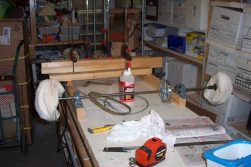

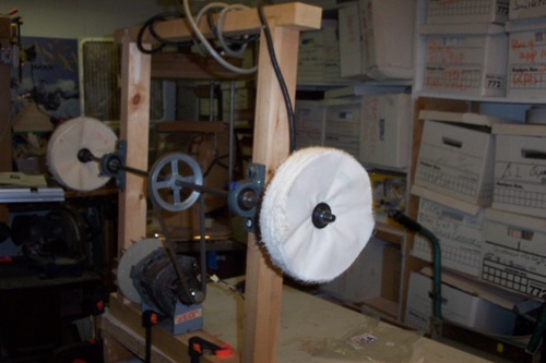

Hello folks, some of you thought i'd stop working in the shop and just play guitar huh? Been busy building myself this cute lil buffer with a motor scrounged(again!) from a drying or washing machine and purchased 2 pillow block bearings and one 1/2" steel rod for the shaft and a pulley, the wood was given to me by a fellow Janitor in block 10 here, total cost with the wheels maybe $60-$70 total! The buffing wheels were bought at Lee Valley, God i love that store!

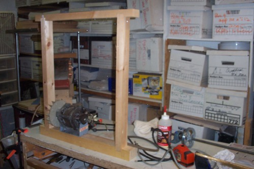

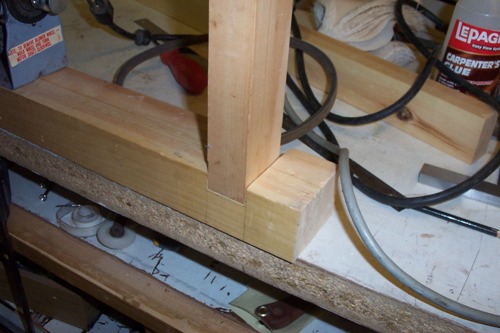

Here it is in construction and assembly mode

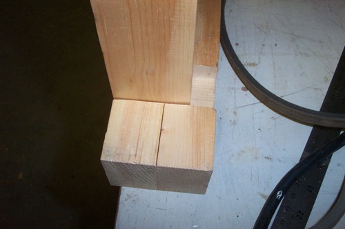

a lamination of 2 planks for the base on which rests the motor and i will add a angled piece there for added support

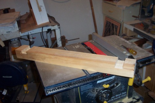

I'm very happy with sawdust flying as you can see, my wife took this pic after i finished cutting the pieces on the table saw!

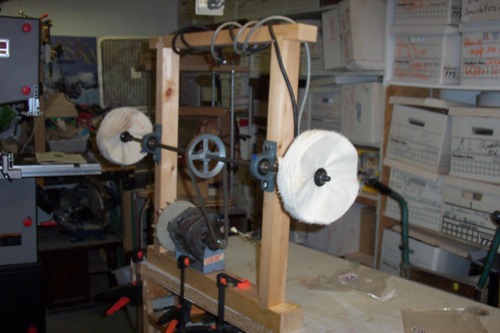

And the finished buffer!
Thanks for watching !!!

Look great Serge. I do have a question for you though. How high is the center of the wheels off of ground level?. The reason I ask is the biggest accident that happens with power buffer is when the wheel grabs the upper edge of the guitar and slams it to the ground or bench. I fins it very dangerous to work a buffer that the wheels are much over waist high. The higher the wheels over waist high the harder it is to control the body in tight areas and the higher the risk of a throw down. but then a gain I am just 5'8" and shrinking
Now I am assuming that you plan to operate it as you have it clamped to your bench. MichaelP38924.6738773148
PostPosted: Wed Jul 26, 2006 7:33 am
Thanks for this clarification Michael, it is way above the waist as you mention and i will take that into consideration before using it, the buffer will be clamped to a lower table and will have the wheels at proper height !
Thanks Michael!

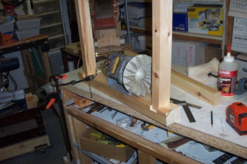

I do have one recommendation though. It looks like there is some kind of fan piece on the motor from whatever the motor came off of. I would do my best to remove it or build some type of cover or guard for it. I would hate to see that grab a shirt while buffing.

Hesh and Colby, Your advices are well received, i will comply with the safety requirements!
I will enclose that fan thingy and the other rotating components that could harm me and will try to cover the back of the buffing wheels, Thanks!

Hesh, i'm not sure of the speed i have with my motor but i think it's a 1/3 hp and it is pretty slow, do you think it's fast enough for buffing?
PostPosted: Wed Jul 26, 2006 2:57 pm
Thanks Hesh, i think you're right on the speed, i prefer to start buffing in a slow fashion, i'll have time to get accustumed to the compound quantity to use and all that jazz, and will do as told safety wise my big brother! Thanks again!
